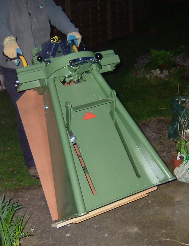

I moved my workshop earlier this year and rented a self drive van with a tail lift which made life very easy moving the morso. I also bought a heavy duty sack trolly and it was a doddle wheeling the morso about... in fact a lot of fun... me missus had to call me in as it was getting dark! :giggle:
I would do as Graysalchemy says and lock the blades down... just noticed I didn't :oops:

The most difficult bit is getting it into and out of the back of a vehicle. A tail lift would make it a doddle, but the flat back of the morso makes it fairly easy to lift and tip into the back of vans/estate cars. Cover the bumper with old carpet to avoid damage. I put some contiboards in my van to ease sliding in and out, but make sure it can't move around in the vehicle.
The machine takes up quite a bit of space in a garage, wheeled dollies are available from several suppliers.
