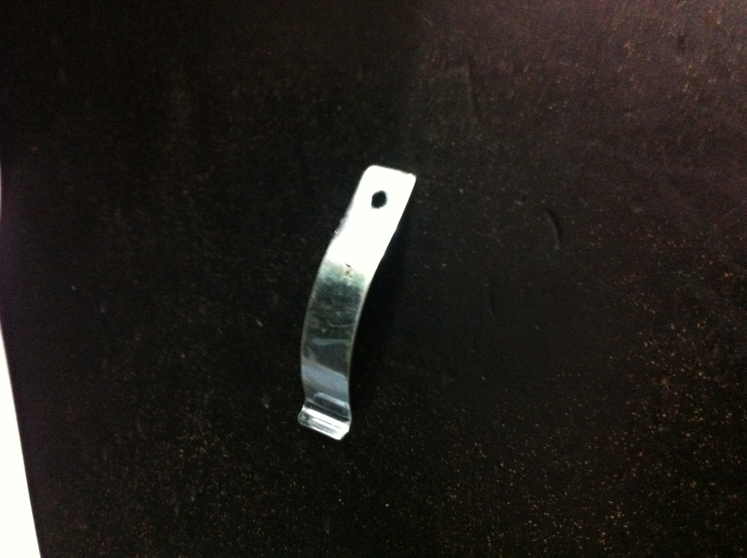

These are the fixing I have by the way,
What I have Pete is an A136 from the Wessex catalogue but at 25mm, they call it a fillet. My fillets are 6mm and are used with mountboard.

I get though 100s of those clips. :D Very handy.
I have these things and have used them but....................... if I'm being completely honest I'm not entirely sure I'm using them properly. :oops: :?

Re: help with framing canvas
Post by Steve N »
If you have a range of mirror plates, you can bend them and use them to hold a canvas in, in fact you can bend them into a right angle and screw to the back of the frame and into the side of the canvas
