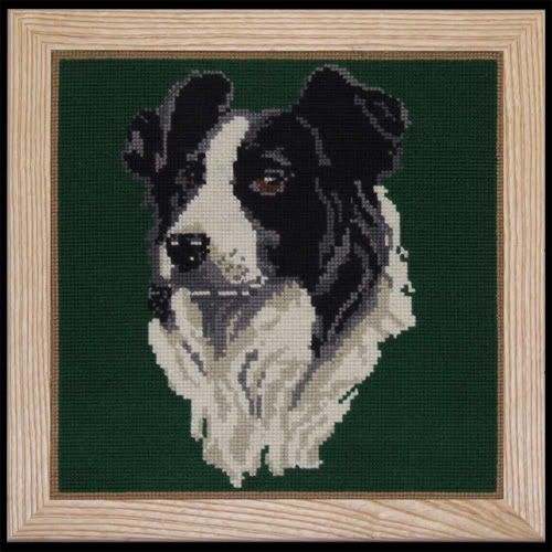

The customer specified that she wanted the tapestry framed without glass and in 38mm plain ash moulding.

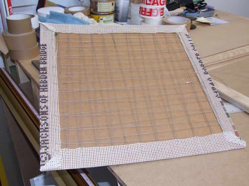

I completed the job this morning using very thin plastic coated hanging wire as the lacing material. The wire was terminated & tensioned using crimps.
The tapestry is supported by Art-bak conservation. Unfortunately I forgot to take a picture of the original before framing but the stitching finished after the second row of the border. Lacing and manouvering the tapestry so that the frame rebate exactly matched the border was a bugger but I think it turned out ok.
The Art-bak did bow quite a bit but I sealed the back with another piece that bowed inwards so hopefully the the package will reamin fat.
Anyway the customer was delighted with the result and the £23.80 bill....

When lacing any type of needlework the lacing thread need to to be weaker in strength than the threads that make up the ground of the needlework. Wire would not be weaker and is not a good choice for this. Something like crochet cotton would have been much more suitable.

If this was needlework on a piece of fabric then I would not have used the wire for lacing. However the lattice material that forms the carrier for the wool knots is not really part of the artwork and indeed a lot may have been cut off had the tapestry been mounted on a stretcher frame and stapled.

I agree with Osgood - wire is stronger that the fabric

As far as lacing is concerned, the current advice is to use a thread that is slightly weaker than the threads in the ground fabric.
If the piece had been stapled onto a frame, it would have been an incorrect practise to cut any of the ground 'lattice' off.
There is one over riding rule that should always be kept in mind when framing anything that is not temporary and worthless:
"Never do anything that cannot be totally reversed!"

Wire is way too strong! It's likely to cut through the tapestry canvas in time....
