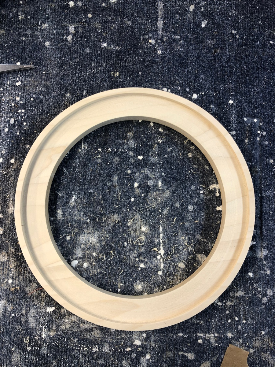

One circular inlay frame cut from tulip.

Re: circular frame
Hi Alan,
You might be getting orders for these.
Nice job.
Nice job.

Re: circular frame
Great job Alan
Peter.
Peter.

Re: circular frame
Many thanks Alan for circular frame
Blends In well

Re: circular frame
Thanks for posting that, always nice to see the final product.
