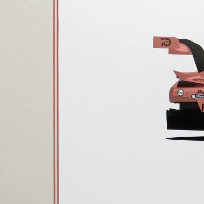

Some examples of coloured bevels, part of a series of Porsche pictures using the same mount and frame but picking out the colours of individual cars with coloured bevels, so they look a matching set but each one is customised to the car.
