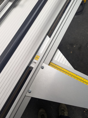

Sure, it's not the best picture but hopefully indicates a little of what the issue is.
So, the wing nut in the picture is supposed to be loosened, and the connecting "bar" drops, and then slides into the channel of the Slideway. In spite of this, I cannot get them to align, as it seems the Slideway is still lower than the T-Bar when put into the base slot of the main unit.

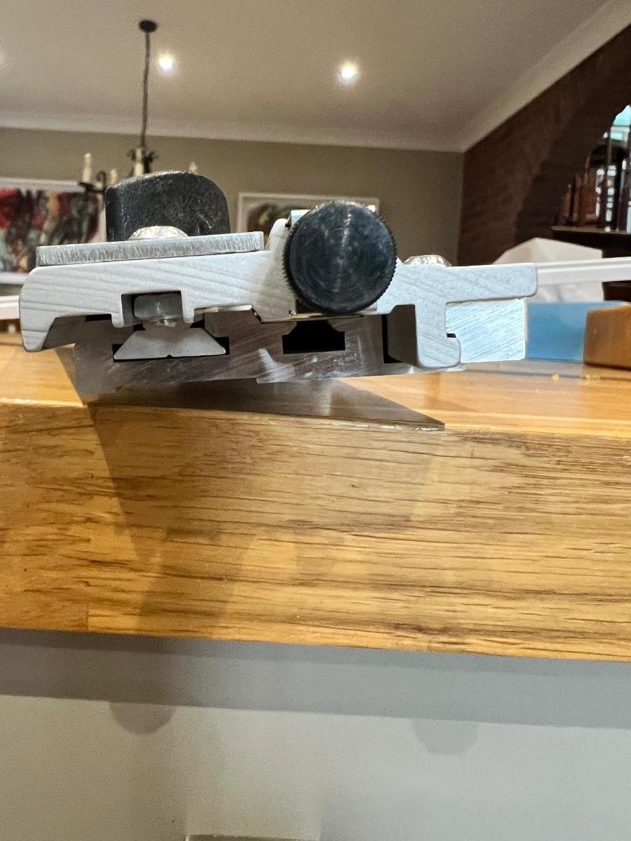

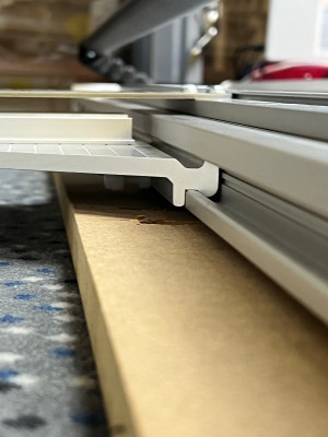

The top T bar needs to slide into the channel on the measuring bar so it sits flush.
Here’s a couple of pictures to illustrate

It has to be like this when you hook it on

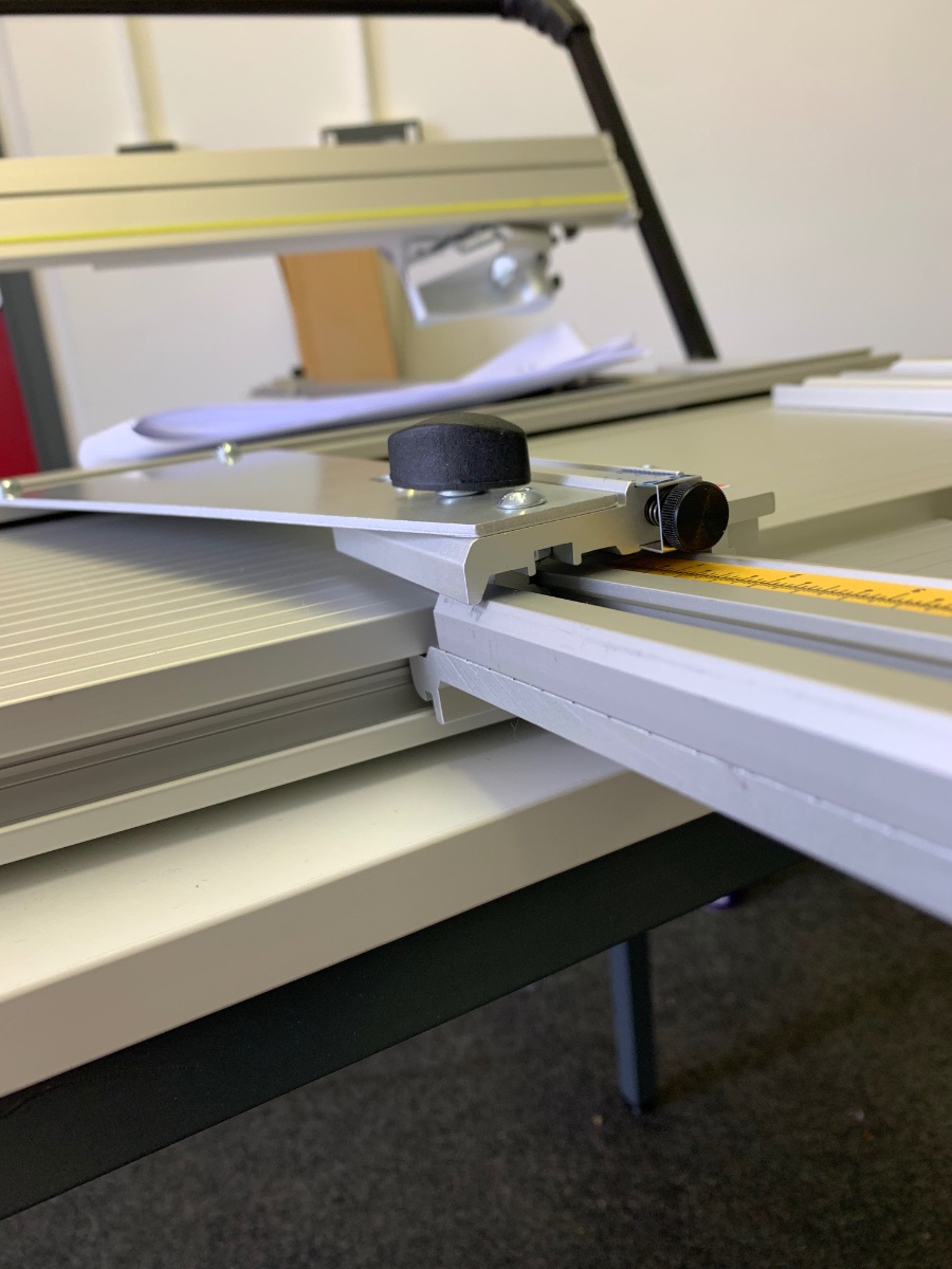

Re: Ultimate Futura T-Bar / Slideway
Then, it looks from your picture that your measuring bar might not be fully seated into the machine. See pictures of mine.
Hopefully even if I haven’t understood the problem, the photos might help
