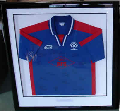

We charge normal frame price, plus £70 for mounting the shirt, ie hand stitch to foam board cut to size.
Think this one was circa £220
But if people would like the cheap option, no mounts and up to the glass, could be as little as £99, but as John says, doing things properly £70 is way too low.
