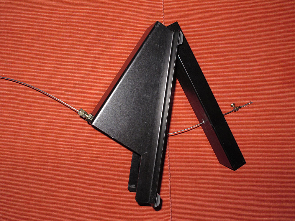

My problem, concerns the locking of the lower end of the cable , in the foot operated clamp.
The cable appears to be locked via a locking screw located inside the RHS pedal portion of the clamp.
It appears almost impossible, to lock the cable in such a way that the friction on the screw is greater that the return spring pressure.
Most grateful for any thoughts or input.

Image attached of the offending item. Outer cable has been removed for clarity.
Has anyone had to replace the inner cable on one of these Guillotines?
Colin
Colin

Re: Old Lion Bench End Guillotine problems
Took another look at your photo - maybe a blow lamp and a blob of solder would have the desired locking effect - could always be reversed by the same method.
