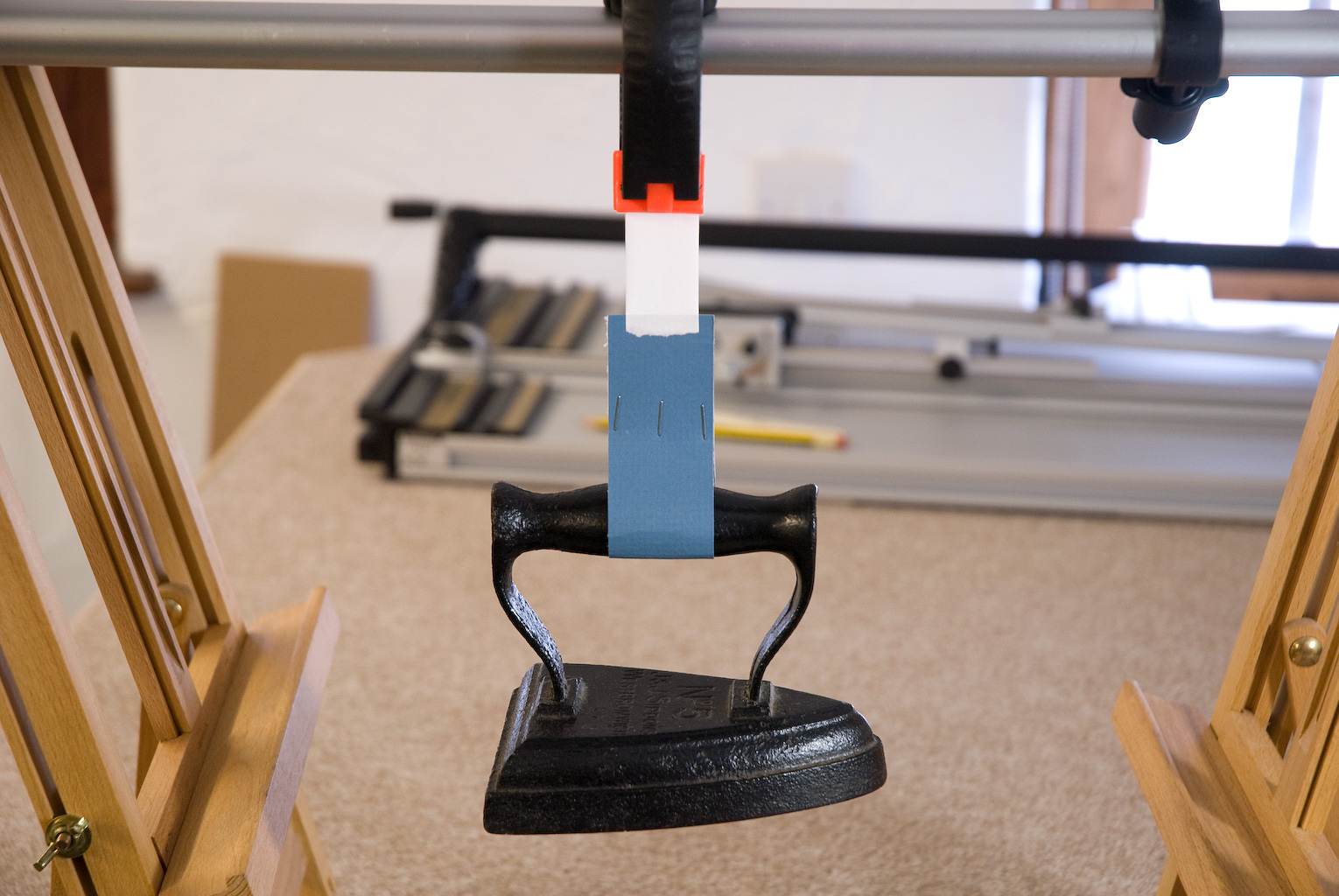

I gave a talk recently about conservation framing and anticipated being asked about how much of the tape should encroach onto the artwork so I demonstrated that 5mm of tape is all that’s needed to support even the heaviest of paper.
The tape in the photo is attached to the card by 6mm.
This is the tape I’ve used:
http://www.lionpic.co.uk/product/RAG-HI ... ,1661.aspx
When cutting paper tape you should always tear it and not use scissors so you don’t get a sharp edge.
BTW, the iron weighs 2kg.
Dave :D

That is very impressive David.
And even though it is (presumably) top quality museum tape, even allowing a 75% deficiency using conventional gummed or self adhesive tape, for hanging photographs, that is still 1/4kilo/250g.
Thanks for the illustration. Much appreciated.
