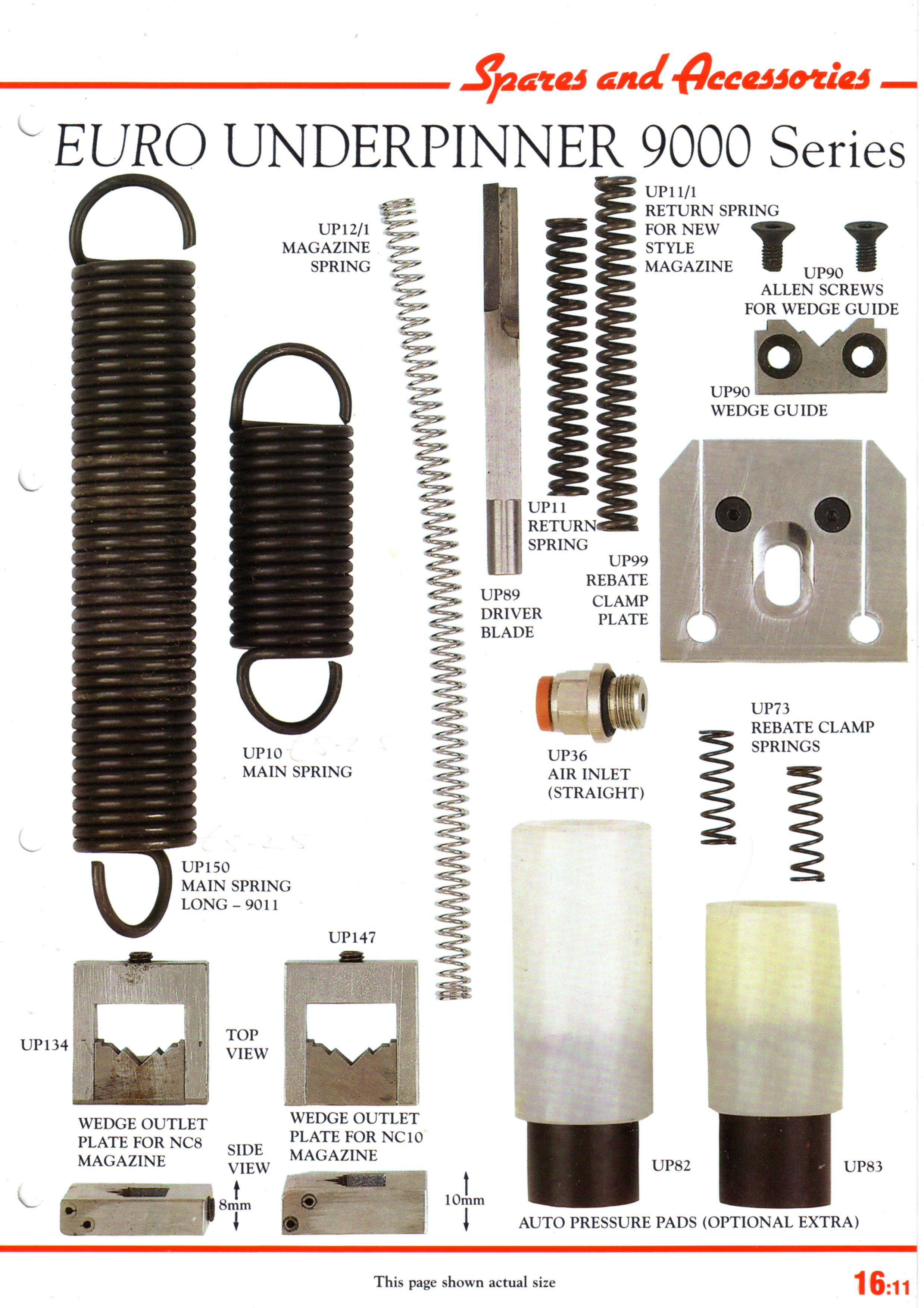

The hammer block as you call it, appears to consist of two parts, but knowing which part you will be needing might be a little bit more complicated than you may be thinking, as there are earlier and later designs for these parts and they are not direct replacements for one another.
The earlier versions of the Euro 9000 series could only be used with 7mm and 10mm wedges (or V-nails). On these earlier versions, what you refer to as the hammer block consisted of the wedge outlet plate for the NC8 magazine (part No: UP134) and the wedge guide (part No: UP90). Please note that as far as I know, the UP134 can only be used with the NC8 magazine. If you are not sure which wedge outlet plate is already fitted to your machine, then the UP134 is the one which is 8mm thick!
The later versions of the Euro 9000 series could be used with 7mm, 10mm, and 12mm wedges (or V-nails). On these later versions, what you refer to as the hammer block consisted of the wedge outlet plate for the NC10 magazine (part No: UP147) and the wedge guide (part No: UP90). Please note that as far as I know, the UP147 can only be used with the NC10 magazine. If you are not sure which wedge outlet plate is already fitted to your machine, then the UP147 is the one which is 10mm thick!
As you will observe the wedge guide (part No: UP90) is used for both magazine types, although after having a quick look at my own machine, I have not been able to see where this part is located within this part of the machine and since I have never needed to dismantle this part of my machine, it may be wise to check exactly where this part is located to know if it requires replacement or not.
In case anyone is wondering, the equivalent parts on Euro 8000 series of manual machines are part Nos: UP148 and UP04. These are and look like totally different parts, which cannot be substituted for parts on the Euro 9000 series machines.
I hope that this information will be of some help to you.

Re: Euro 9009 Again
This might prove useful to someone.
Euro 9000 underpinner spares.jpg (910.16 KiB) Viewed 9001 times
