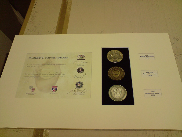

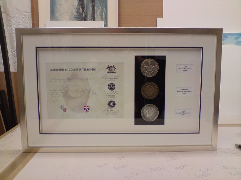

These 3 medals are sunk into the velvet, which is stuck onto foamcore......these were easy to do this way as they dont have any ribbons and they were to match the way they came in the presentation boxes.......not very good pics though

This looks really effective, thanks for posting the pics, I like it because it's a modern display of the medals, I've only ever seen military ones displayed in a more traditional fashion, this looks really slick, nice oneeasypopsgcf wrote:These 3 medals are sunk into the velvet, which is stuck onto foamcore......these were easy to do this way as they dont have any ribbons and they were to match the way they came in the presentation boxes.......not very good pics though

ThanksBagpuss wrote: This looks really effective, thanks for posting the pics, I like it because it's a modern display of the medals, I've only ever seen military ones displayed in a more traditional fashion, this looks really slick, nice one
