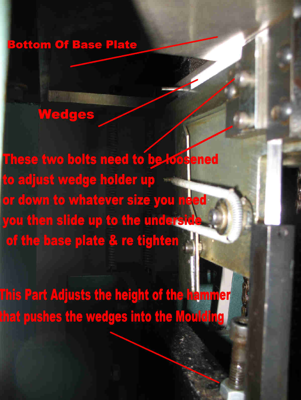

But at the front of that block there two holes that can be uses to clear any wedges that may get jammed or just to push the wedges
along to get them out, i use the long end of a thin allen key
cassese uni wedges both hardwood & soft wood

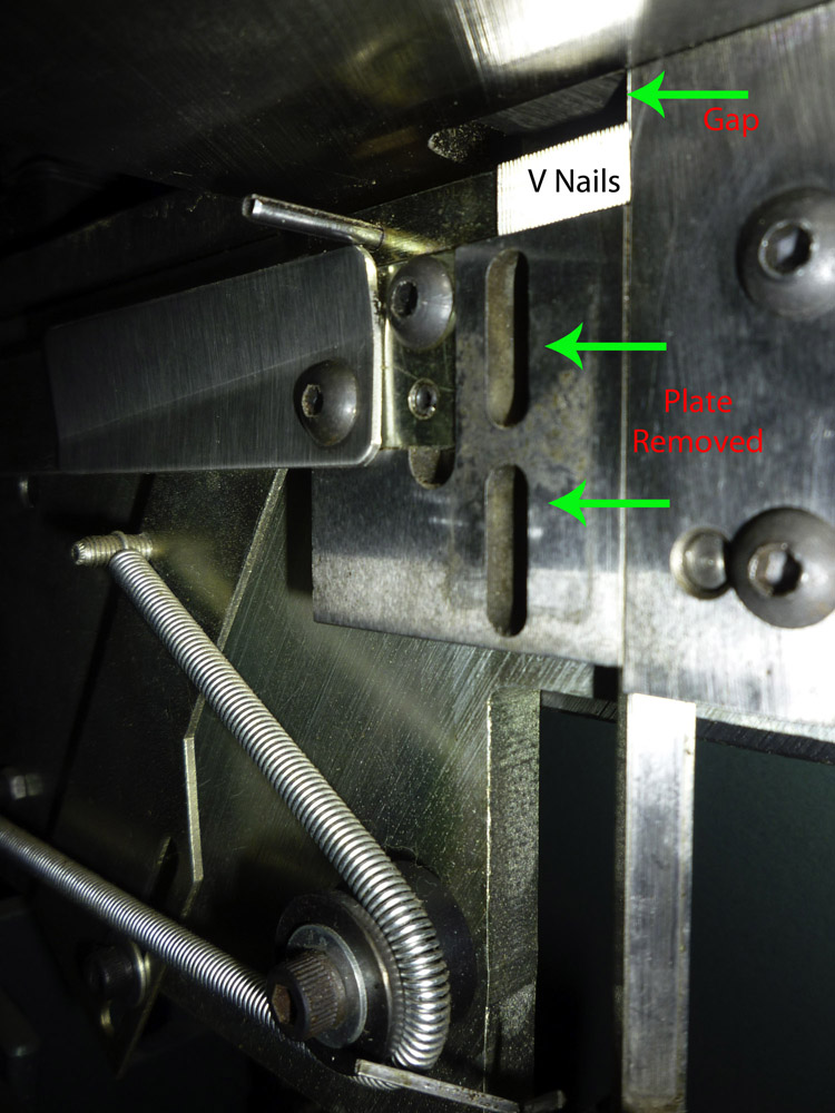

I took the 2 screws out and tried to adjust the plate but the screws seemed as though they would only go in the original location. As you are aware space is very confined and it is difficult to see. I've posted a photo with the plate removed. Is the screw next to these supposed to be loosened so that the plate goes up (for my smaller nails)?
Also, what regular maintenance do you do on your machine e.g. oiling any parts ?
Cliff

You don't have to remove the plate just loosen the Screws & the whole ledge that you put your v nails on should move up & down,
It can be a bit stiff, once you have your nails in place just push he arm up until your nails touch the underside of the base plate & re-tighten the screws reset your sliding v nail tensioner the push your hammer up by hand to make sure your nails are coming up smoothly
if you need to talk give me a ring number on website.

Thanks Ricky. Sorted at last. It took a nudge from a rubber headed hammer to move the block. It took a lot of trial and error to get the hammer working to the right depth.
Thanks again.
Cliff
