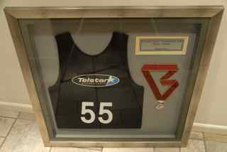

What do you think?
- Framed shirt full pic.jpg (10.07 KiB) Viewed 5503 times
- Framed shirt medal & plaque.jpg (8.43 KiB) Viewed 5503 times
- Framed shirt full top shot.jpg (9.93 KiB) Viewed 5503 times

This frame look very nice, but I'm puzzled by the whitish background not going all the way to the top of the frame?
I can't see in the photos, how this works and don't understand why it is that way. Can you please enlighten me???
Re: HELP AND IDEAS PLEASE
Hi Ormond, Perhaps its a shadow box!
at least I think that's what you mean??

Thank you all, it is very important to hear your views especially if they are positive.
Stone Grey backing board is how it should be, what you see is a heavy shadow cast as a result of ceiling down lights illuminating the picture.
